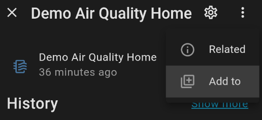

When using Home Assistant 2025.12 or newer, you can also create a widget directly from an entity by opening the entity's more info (accessible by tapping on the entity or via the overflow menu). In more info, select Add to and choose to add a widget. Note that this feature is only supported for compatible entity types, and you must perform this action on the device where you want the widget to appear.
Home Assistant more-info dialog Add to
