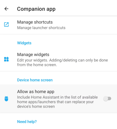

Enabling Home Assistant as the home app​
  1. Open the Home Assistant app.
  2. Go to Settings > Companion app.
  3. Scroll down to Device home screen.
  4. Enable Use as Home app (launcher).
    Screenshot showing allow as home app

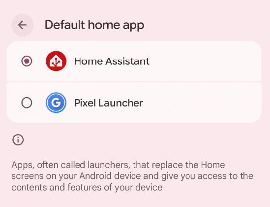

  5. To open the system screen that allows you to pick a home app, select Change home app.
    Screenshot showing choose a home app system screen

  4. To open the system screen that allows you to pick a home app other than Home Assistant, select Change home app.
